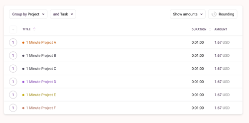

Here's an example: We have six Projects. Each Project has an hourly rate of €100, and a total tracked time of 1 minute each.

Like on any other service that displays money values, the billable amounts are rounded to two decimal places. So on the Summary Report, the Projects would be listed like so:

However, manually summing up the values displayed in the Summary Report would result in €10.02. This is because you're adding items that have already been rounded up.
